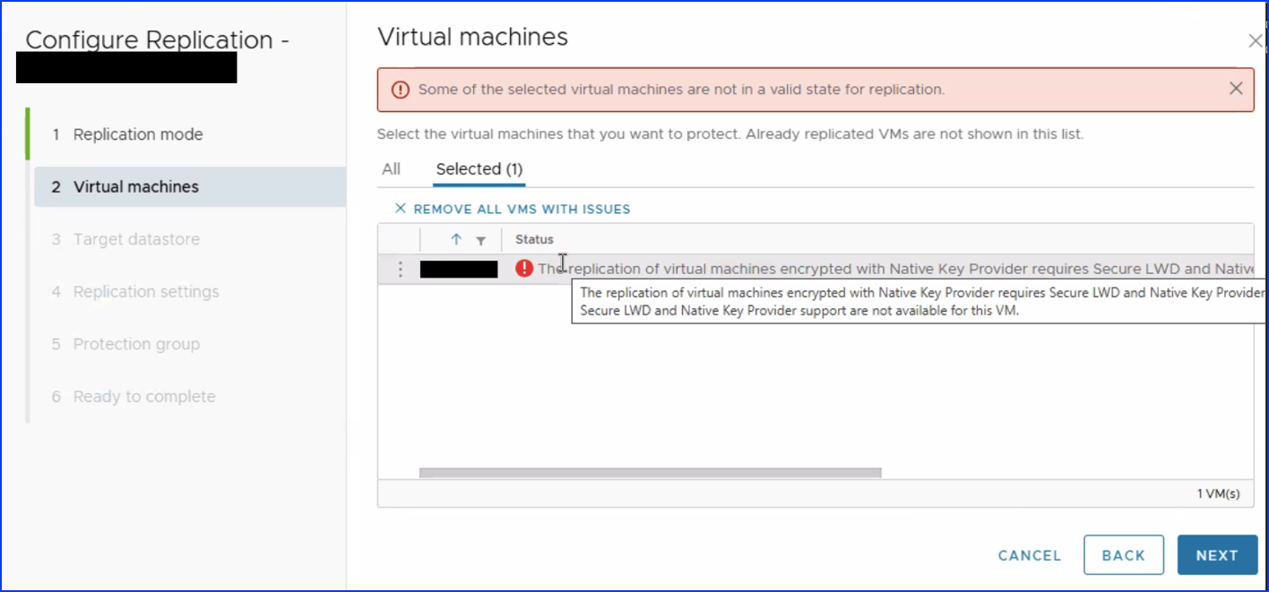

Error : "The replication of virtual machines encrypted with Native Key Provider requires Secure LWD and Native Key Provider support. Secure LWD and Native Key Provider support are not available for this VM."

Symptoms:
  • After configuring vTPM on a virtual machine and on configuring it for replication following error is observed:
    "The replication of virtual machines encrypted with Native Key Provider requires Secure LWD and Native Key Provider support. Secure LWD and Native Key Provider support are not available for this VM.".
