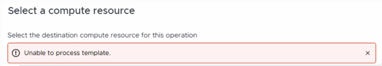

While deploying Virtual Machine from the content library, getting error "Unable to Process template" as the underlying datastore is inaccessible
Article ID: 429441
VMware vCenter Server
While deploying template from the content library, it succeeds the compatibility check with ESXI host, however fails upon clicking Next.

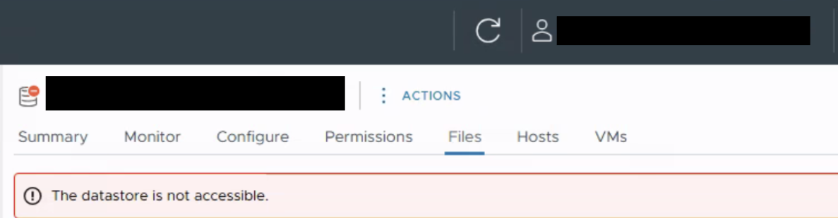

This issue can occur, if the content library files are referencing to a datastore that is inaccessible.
  • Validate, why the datastore is inaccessible
  • Fix the inaccessible datastore and perform resync
  • Performing resync will update the vCenter database and template files will start reflecting in the datastore
  • Proceed with deployment of the virtual machine from the template.
