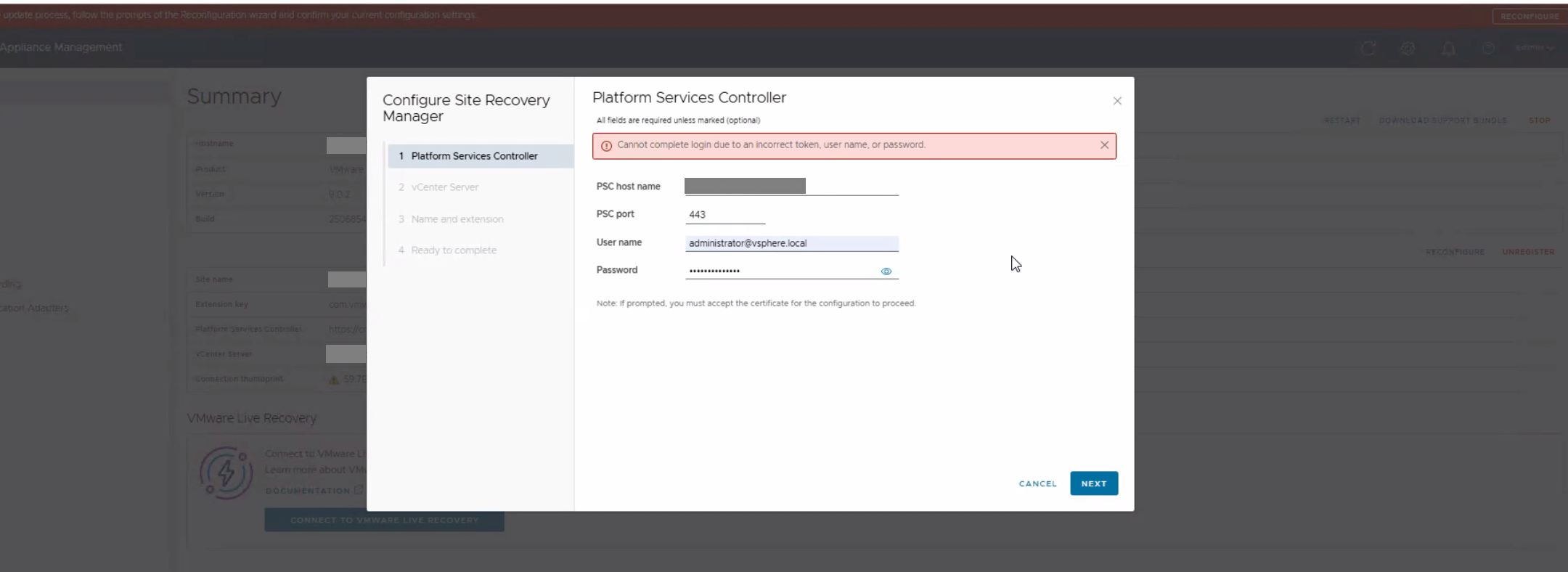

When attempting to reconfigure the VMware Live Site Recovery (VLSR) 9.0.x appliance to the vCenter Server, the operation fails.
  • The VLR Appliance Management Interface (VAMI) returns the following error message during the "Connect to vCenter" or "Reconfigure" task: Cannot complete login due to an incorrect token, user name, or password
  • This occurs even when the credentials provided for the vCenter Single Sign-On (SSO) administrator are verified as correct.
