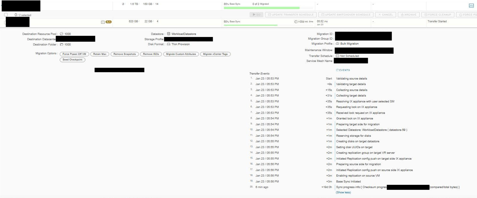

Virtual machines been stuck at the base sync stage for multiple days without any progress.

  • VM replication tasks remain in progress without completion.
  • Bulk migration does not proceed been stuck at the base sync:
