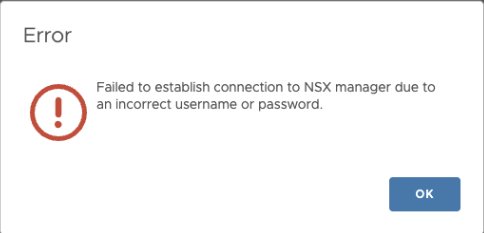

Validation of NSX cloud account integration fails within VCF Operations. This typically occurs when system-managed credentials fall out of synchronization.
  • NSX adapter instance displays a "Warning" status.
  • Manual "Test Connection" fails with: Error - Failed to establish connection to NSX manager due to an incorrect username or password.
  • /storage/log/vcops/log/analytics-<id>.log contains: Failed to create service accounts. SvcAccountsCreationResult is null.

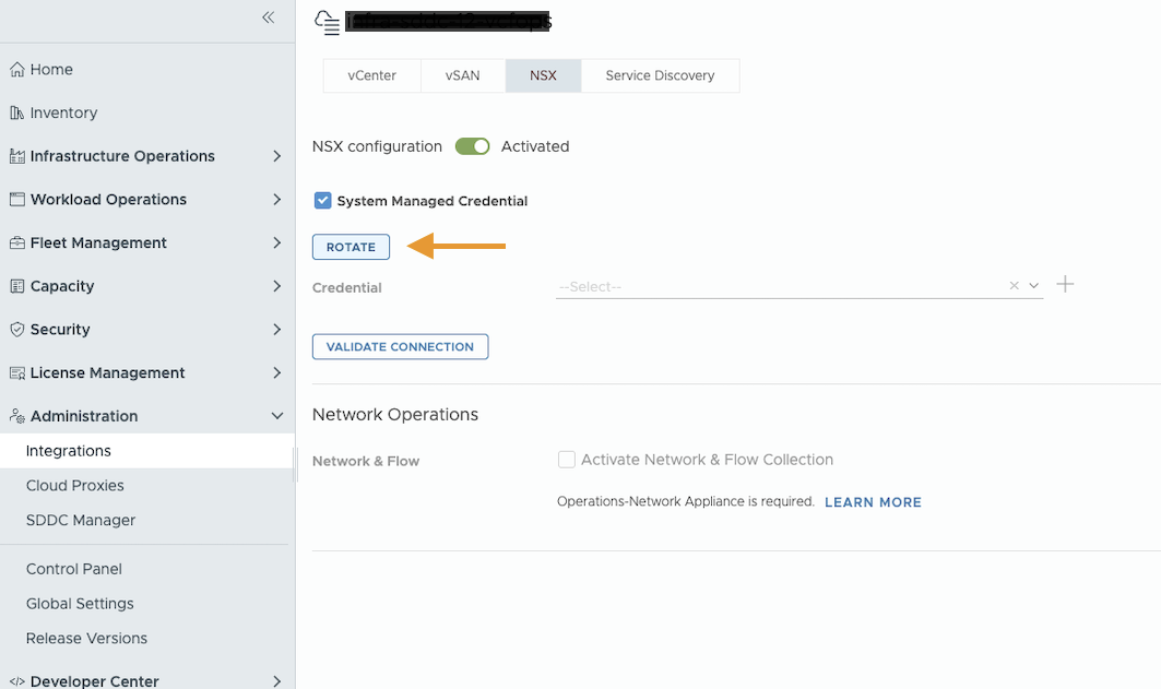

  1. Log into SDDC Manager UI and navigate to Administration → Password Management.
  2. Locate the NSX Manager "root" account. If status is "Disconnected," click Remediate and provide current valid credentials to restore "Connected" status.
  3. Log into VCF Operations UI and navigate to Administration → Integrations.
  4. Expand the VCF Instance, select the impacted domain, and click the NSX tab.
  5. Next to System managed credentials, click Rotate. (The existing service account gets deleted and a new service account is created).
  6. Save the configuration and perform a Test Connection.
    Note: Same applies for vCenter Server account.
