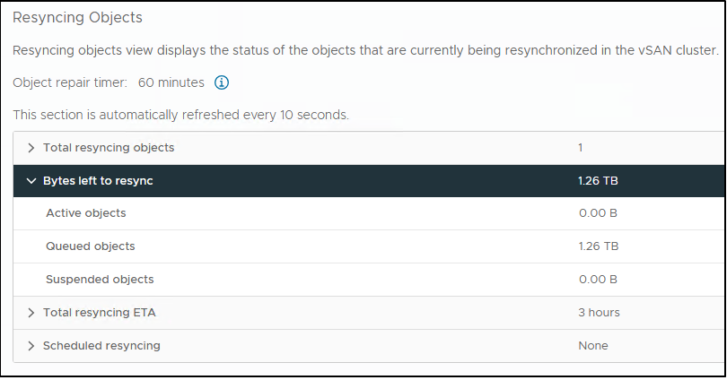

The issue is caused due to a vSAN object sync taking longer than expected. The error DECOM_STATE_INVALID indicates a stuck state within the vSAN Control Plane.
Validate the same using the vCenter Server UI
vCenter UI > Cluster > Monitor > vSAN > Resyncing Object will show the amount of data to resync and estimated time to complete the resync.
