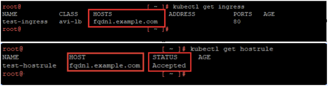

  • This issue occurs when an existing Ingress and HostRule are deleted and recreated with a new FQDN, while the previous FQDN is referenced as an alias in the new HostRule configuration.
    • An Ingress and HostRule are created with the FQDN fqdn1.example.com, and the HostRule status shows Accepted.

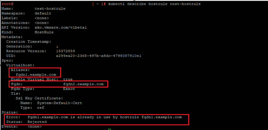

    • Later, the Ingress for fqdn1.example.com is deleted and recreated with the new FQDN fqdn2.example.com
    • Next, the existing HostRule for fqdn1.example.com is deleted and recreated with fqdn2.example.com as the FQDN and fqdn1.example.com as the alias.
    • When the HostRule is described, the status shows Rejected with the error:  fqdn1.example.com is already in use by hostrule fqdn1.example.com
    • AKO logs also show validation errors indicating that the FQDN is already in use, causing the HostRule to remain in the Rejected state even though the previous Ingress and HostRule referencing the old FQDN were deleted.
