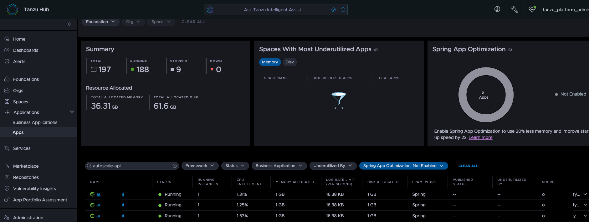

You attempted to enable spring app optimization for an application using the following command and restaged the app.

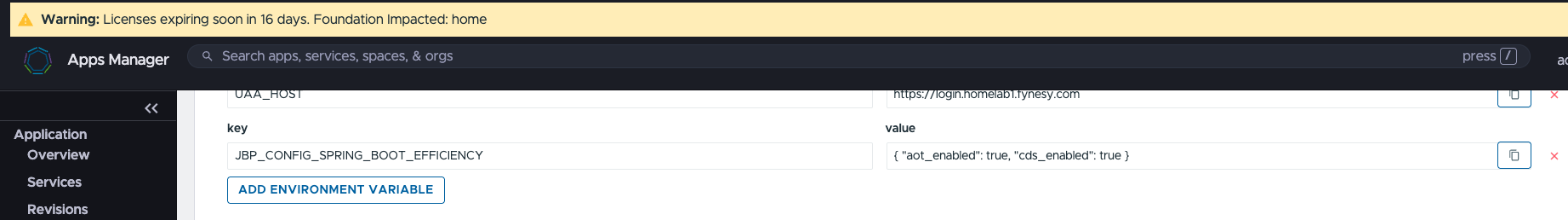

$ cf set-env APP_NAME JBP_CONFIG_SPRING_BOOT_EFFICIENCY '{ aot_enabled: true, "cds_enabled": true }'
Post the app start, you confirmed both values were set correctly by checking the env setting via either CF CLI or apps manager.
However, the app is still being displayed when you set the filter to "Spring App Optimization: Not Enabled" in the Tanzu Hub UI.
Both aot_enabled and cds_enabled have been deprecated so setting the app env with these two values will not make the Tanzu Hub recognize the app as "spring app optimization: enabled".

So now you need to run a command similar to the following to enable the spring app optimization for an app and then restage it. Then you would be able to see the app being recognized as a "spring app optimization: enabled" app in the Tanzu Hub UI.
$ cf set-env APP_NAME JBP_CONFIG_SPRING_BOOT_EFFICIENCY '{ aot_cache_enabled: true, spring_aot_enabled: true }'
