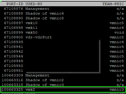

When this issue occurs the following behavior may be seen:
esxtop > enter > letter "n". In the example below, the vmkernel adapter vmk2 is responsible for vMotion and is currently using vmnic3:VMware vSphere ESXi
