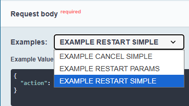

There is an endpoint that can do this which is the POST method for /{client_id}/executions/{run_id}/status.  Under the example dropdown, there are options for restarts:
The EXAMPLE RESTART SIMPLE has a simple body like:
  "action": "RESTART"
and will have the same behavior as RESTART_UC_OBJECT (Object Name, Reference RUN#) that is referenced in the documentation for RESTART_UC_OBJECT.
