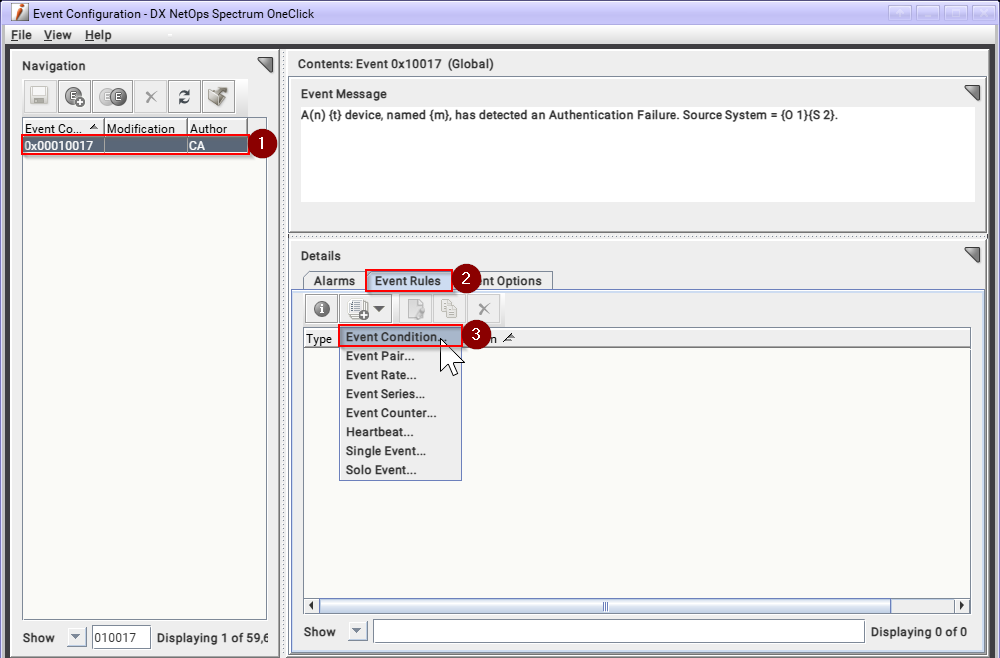

1. In the Event Configuration Editor, locate the event code you want to customize. Select it and in the Event Rules tab, select Event Condition... option:
In this example, the 0x10017 was chosen. Select your event code you want to customize.

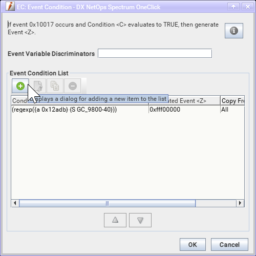

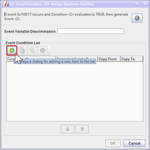

2. Click on the "+" signal icon to create your event condition rule:

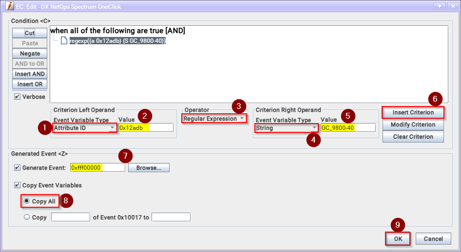

3. Select as follow:
Click on Insert Criterion button
Supply the Generate Event: (supply your custom event code - when the device belongs to the GC)
Select Copy All and click on OK button

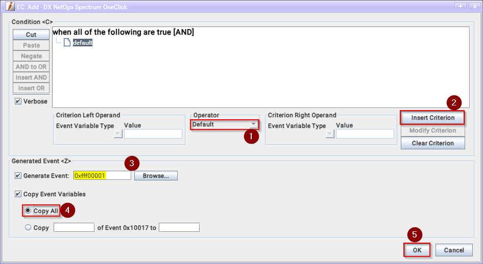

4. Click on the "+" signal to create the default rule:
5. Select as follow:
Operator: Default
Supply the Generate Event: (supply your custom event code - when the device does not belong to the GC)

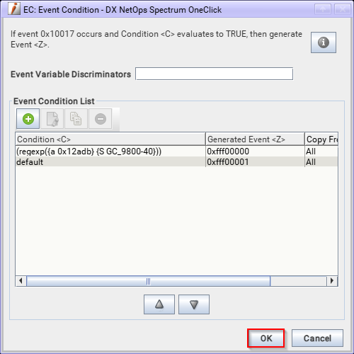

6. Click OK button:

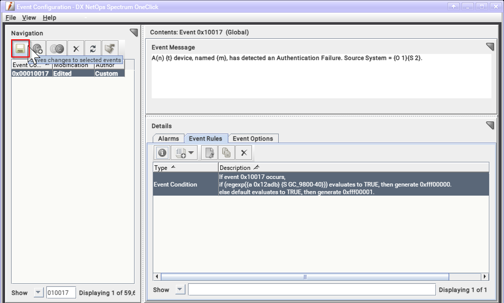

7. Click on the Save button:
Now once the 0x10017 event is generate, it will evaluate if the device belongs to Global Collection called GC_9800-40. If positive, it will generate event 0xfff00000. If the device does not belong to Global Collection called GC_9800-40, it will generate event 0xfff00001.
