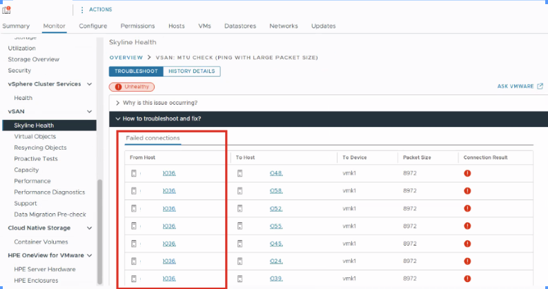

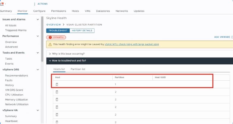

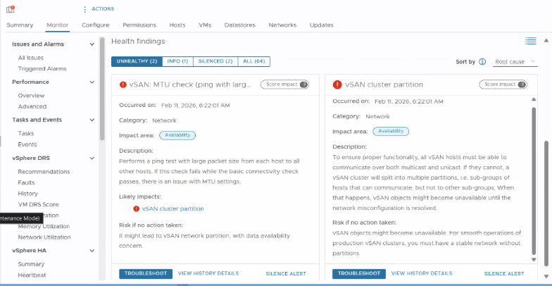

The following alerts were observed in vSAN Skyline Health for cluster:
  • vSAN: Cluster partition
  • vSAN: MTU Check (ping with large packet size)
  • Further verification show that the host is not reachable from other hosts in the cluster over vsan vmkernel.

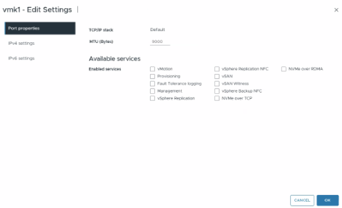

Further validate the vmkernel configuration on ESXi host confirm that vSAN traffic is not enabled on the vmkernel adapter.
  • Enable vSAN traffic on vmkernel for the affected ESXi host.
