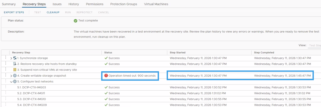

  1. Test Recovery takes a long time to complete and fails with, Operation timed out: 900 seconds.
  2. VM fails on 'Change recovery site storage to writable' step and displays : Operation timed out: 900 seconds
  3. Re-running the Test Recovery plan fails with same error.
  4. The failure issue is seen only on VM with large disk size.
  5. When Test Recovery is initiated without selecting option - "Replicate recent changes to recovery site" as per below screenshot,
    The error does not occurs and plan successfully completes.

The VMs containing multiple virtual disks. During the recovery phase, an incremental sync is initiated, which requires merging the associated hbrdisks (replication logs) with the parent disks. Due to the volume of data, this consolidation process takes a significant amount of time to complete, triggering 'Operation timed out' errors.
  • From the logs of /opt/vmware/support/logs/srm/vmware-dr.log displays timeout exceeding 900 seconds,
####-##-##T##:##:09.060Z verbose vmware-dr[01385] [SRM@6876 sub=Replication opID=########-####-####-####-############-failover:b1a1:f93f:c124:2957] HandleEntityCompletion: Queuing callback for completion of protected VM Id=[dr.replication.ProtectedVm:########-####-####-####-############:protected-vm-######]
####-##-##T##:##:09.061Z error vmware-dr[39179] [SRM@6876 sub=Replication.VmRecoveryInterface ctxID=b9a6720f opID=########-####-####-####-############-failover:####:####:####] Protection VM 'dr.replication.ProtectedVm:protected-vm-######' failed operation 'Recover'! There are '0' warnings for this Protection Group. Failure Reason: N2Dr16TimeoutExceptionE Operation timed out after '900.000591' seconds
[context]zKq7AVECAAQAAL/UWwEJdm13YXJlLWRyAADM6xtsaWJ2bWFjb3JlLnNvAAFZCw9saWJjb25uZWN0aW9uLWJhc2Uuc28AApg6A2xpYmZ1bmN0aW9uYWwuc28AAIKvQQDeSDUA4mE1ALCLSgOujgBsaWJwdGhyZWFkLnNvLjAABC/eD2xpYmMuc28uNgA=[/context]
  • From /var/log/vmware/hbrsrv.log, shows below events
####-##-##T18:45:06.155Z info hbrsrv[01629] [Originator@6876 sub=StatsLog groupID=GID-########-####-####-####-############ opID=hsl-246a8da0] HbrEvent: {"eventID":"consolidateProgress","groupID":"GID-########-####-####-####-############","percentCompleted":75,"ETA":"####-##-##T01:45:47.155268Z","serverID":"########-####-####-####-############","hbrEvent":1}
  • The Test Recovery report shows Disk consolidation for VM ETA or completion time is 1:45:47. The Time of completion is beyond default timeout time 15 mins (900 seconds) as per Test completion report
