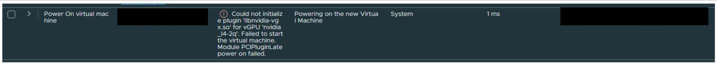

Error: "Could not initialize plugin /usr/lib64/vmware/plugin/libnvidia-vgx.so" when powering on NVIDIA vGPU VMs
Article ID: 429077
VMware vSphere ESXi
  • Virtual Machines configured with NVIDIA vGPU fail to power on. This issue is typically caused by SR-IOV (Single Root I/O Virtualization) being disabled in the server BIOS.
  • SSH into the ESXi host and check /var/run/log/vmkernel.log: Explicit warnings indicate the BIOS is blocking Virtual Functions (VFs):
    WARNING: PCI: 1615: Enable VFs failed... Please make sure the system has proper BIOS installed and enabled for SRIOV.
    NVRM: SRIOV may be disabled
  • Within the same SSH session, check /var/log/hostd.log: The license manager reports sriov = 0, confirming the feature is unavailable to the hypervisor:
    LicFeature ... sriov = 0, ... vgpu = 0
