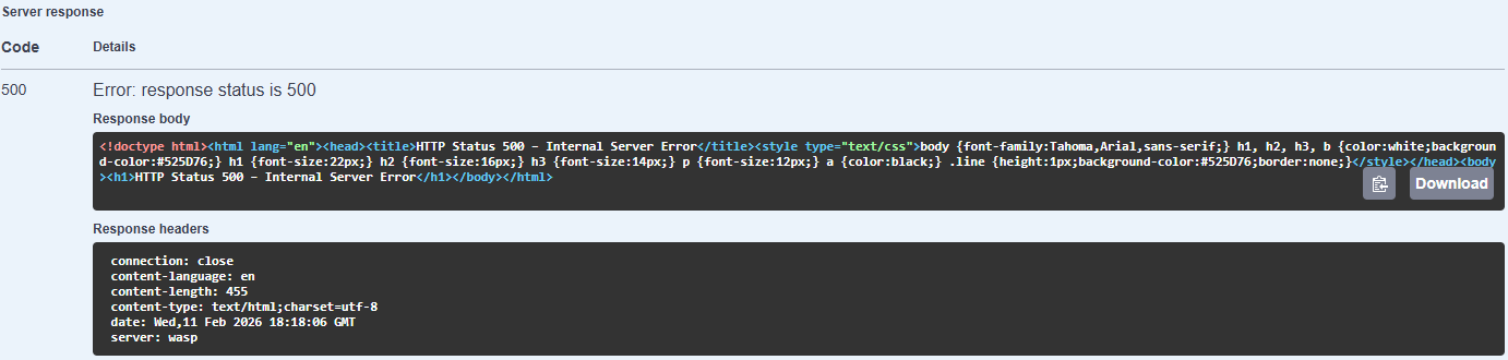

After upgrading to DX UIM 23.4 CU6, all UIM Swagger calls are returning 500 – Internal Server Error.
<!doctype html><html lang="en"><head><title>HTTP Status 500 – Internal Server Error</title><style>
