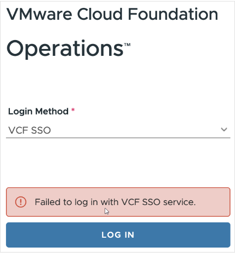

  • Users are unable to log in to VMware Cloud Foundation (VCF) Operations using Single Sign-On (SSO). The login attempt fails immediately with the error message: Failed to log in with VCF SSO service
