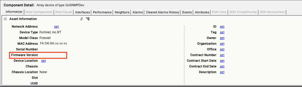

Array Devices not showing firmware value under Asset Information in Spectrum:
DX NetOps Spectrum all currently supported releases
The Array device has System OID (SysOID) of 1.3.6.1.4.1.7564.1.0 and is not currently certified in Spectrum. When discovered, it only appears as a Generic device (GnSNMPDev).
So the OID containing the Firmware version is not known to Spectrum and is not mapped to an attribute in NRM_RunningFirmwareAttr, which is used to display the store and display the Firmware value as per:
Contact the vendor (Array) to identify the OID that contains the Firmware version. Then follow the process outlined in the following KBs to add it to the devices' Model_Type:
KB : Spectrum NRM_RunningFirmware attribute not populating for some device models.
and
KB : Fortigate 200F devices not showing the Firmware version in Spectrum (NOTE: While this is about the Fortigate 200F device, the process is the same for all)
