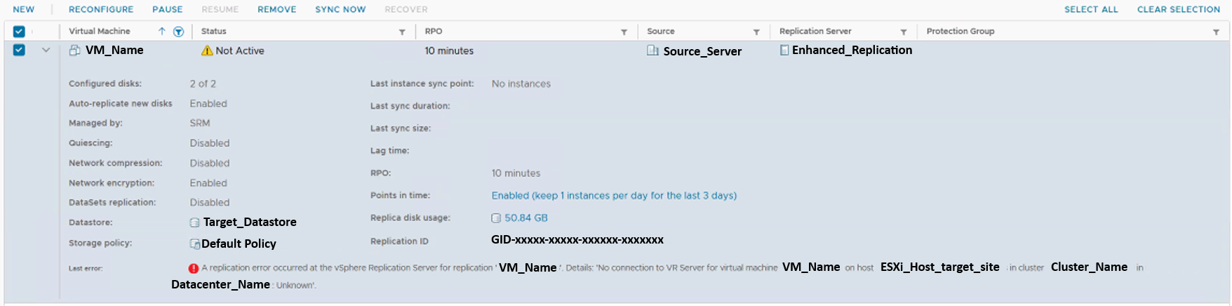

  1. The VMs in Replication appears with below error,
    Error - A Replication error occurred at the vSphere replication Server for replication 'VM_Name'. details : 'No connection to VR server for virtual machine VM_Name on host Host_name in Cluster Cluster_Name in Data_center: Unknown'.
    Warning - Not Active (RPO Violation).

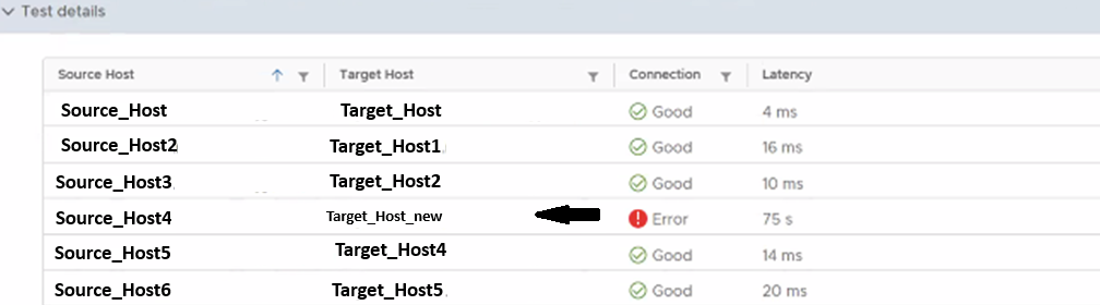

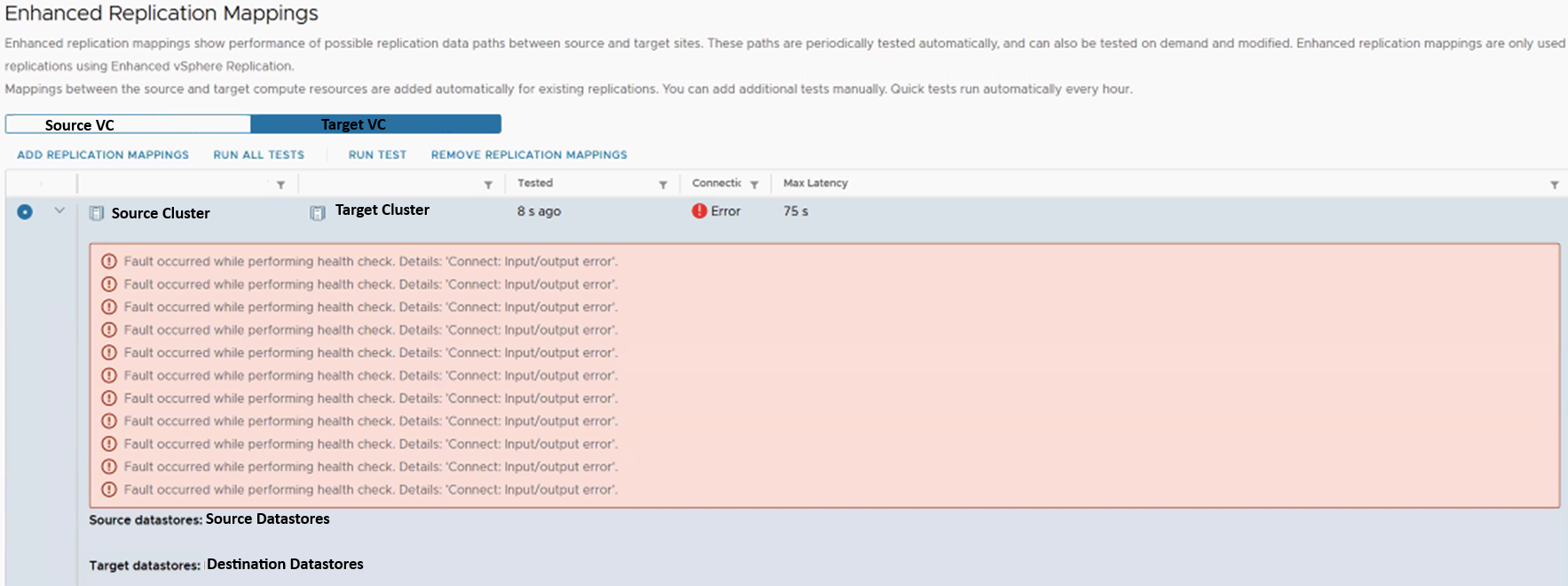

  2. The Mappings under Enhanced replication appears with below error,
  3. The ESXi host was recently added to the environment. Immediately following this addition, the enhanced replication mappings began displaying the error below

  • The enhanced replication and mappings are failing because the hbr-agent service on the newly added ESXi hosts cannot authenticate with the target ESXi hosts and the vSphere Replication appliance over port 32032. This authentication failure is caused by an invalid broker certificate, which prevents the hbr-agent from logging in successfully. As a result, VMs remain in a 'Not Active' state or fail to replicate entirely.
