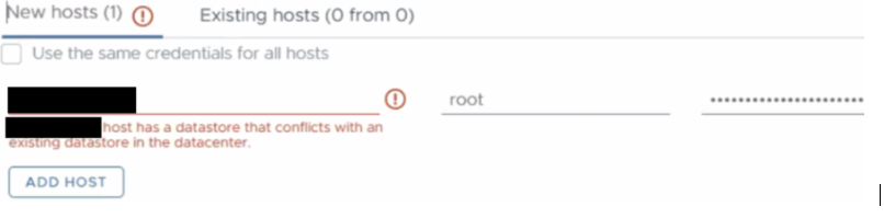

  • Attempting to add ESXi host to vCenter fails with an error: "Host has a Datastore that conflicts with an existing Datastore in the Datacenter"

  • The primary cause of this behavior is DNS inconsistency. During the host addition process, vCenter performs forward and reverse lookups to validate the host's identity.
  • In this scenario, performing an nslookup from the vCenter Server to the ESXi host reveals two different FQDN (Fully Qualified Domain Name) entries associated with the same IP address.
To resolve this issue, the stale or Duplicate DNS records must be mapped to ensure a 1:1 mapping between the Hostname, FQDN, and IP address.
      Verify the Duplicate Entry and Clean up DNS Records
  1. Access your DNS Server (e.g. Windows DNS Manager).
  2. Locate the Forward Lookup Zone and Reverse Lookup Zone for your management network.
  3. Search for the ESXi host's IP and Name.
  4. Remove the duplicate or stale FQDN entry.
  5. Ensure only one record for the ESXI host exist there
  6. Try to Add the ESXI host back to the vCenter
