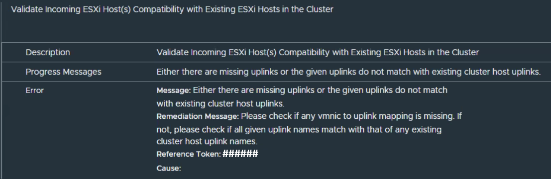

  • When attempting to commission or add a host to an existing cluster via VCF Operations or SDDC Manager, the task fails during the validation phase.
  • The UI reports a compatibility mismatch between the incoming host and the existing hosts in the cluster regarding network uplink configurations.
  • The VCF Operations/SDDC Manager UI displays the following error:

This issue occurs when the Network Selection or the Uplink Mapping defined in the Host Commissioning spec (JSON or UI input) does not match the hardware or logical configuration of the existing hosts within the target cluster.
To resolve this, you must ensure the networking metadata for the new host perfectly aligns with the established cluster members.
