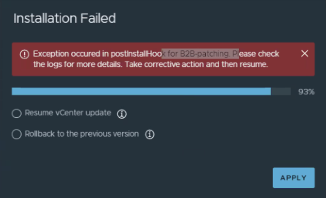

  • Attempting to update vCenter Server to version 8.0 Update 3h Build 25092719 using the vCenter Server Appliance Management Interface (VAMI), the operation fails with the following error:
    "Exception occurred in postInstallHook for B2B-patching. Please check the logs for more details. Take corrective action and then resume".
