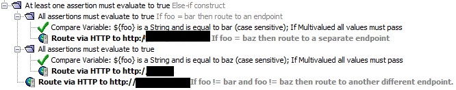

Else-if Construct
An else-if construct allows a programmer to specify a particular action to execute should a particular condition be met. If that condition is not met, then the program will check a new condition and perform a different action. A default action can also be specified should none of the conditions be met.
Summary
The Gateway is capable of simulating the aforementioned constructs and many other styles of conditional statements by leveraging the All assertions must evaluation to true and At least one assertion must evaluate to true assertions. These assertions behave in a predictable manner and can be applied in varying quantities and in varying levels of nesting to construct the conditional statement that meets your needs.
