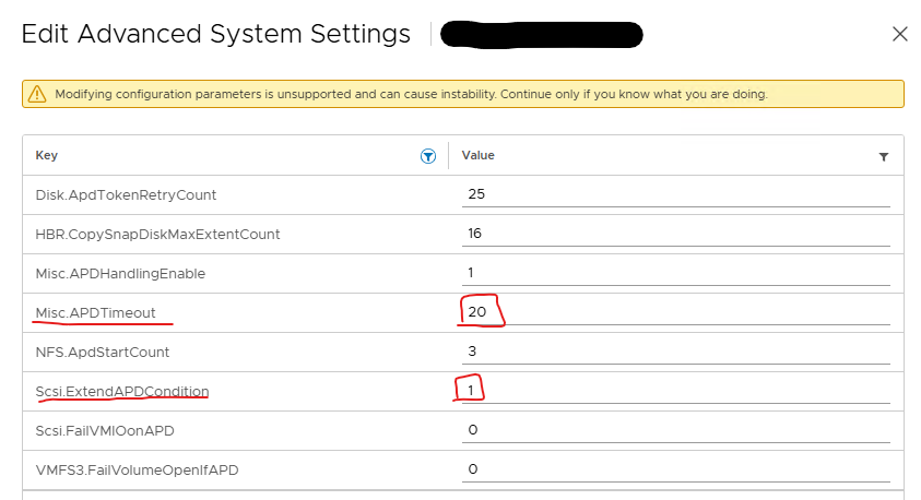

The fix is disabled by default. To enable the fix, set the ESXi config option Scsi.ExtendAPDCondition to 1 in the advanced settings of the host -> click Edit -> you can search for APD in the filter to find this
Also lower the Misc.APDTimeout timer (minimum = 20secs)
This will not be instantaneous failover but will take a short period of time, However it will not keep the Datastore connected like before and will force a HA failover - this is depending on your setting on the HA, and APD settings in the HA and aslo how many seconds you set on the Misc.APDTimeout timer.
