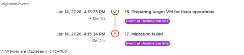

ERROR c.v.v.h.s.m.h.OsAssistedMigrationUtil- Task Failed. {"fault":{"@xsi:type":"InvalidArgument","invalidProperty":"fileType"},"localizedMessage":"A specified parameter was not correct: fileType"} app.log at /common/logs/admin from HCX Manager shows following error2026-01-25 06:31:09.022 UTC [OsAssistedMigrationService_SvcThread-371, Ent: HybridityAdmin, , TxId: ########-####-####-####-#######] ERROR c.v.v.h.s.m.h.OsAssistedMigrationUtil- Task Failed. {"fault":{"@xsi:type":"InvalidArgument","invalidProperty":"fileType"},"localizedMessage":"A specified parameter was not correct: fileType"} 2026-01-25 06:31:09.039 UTC [OsAssistedMigrationService_SvcThread-371, Ent: HybridityAdmin, , TxId: ########-####-####-####-####### ] ERROR c.v.v.h.s.m.jobs.LinuxFixupJob- Failed in executing subworkflow Linux Fixup - A specified parameter was not correct: fileType migrationId: ######-####-####-###-######### 2026-01-25 06:31:09.162 UTC [OsAssistedMigrationService_SvcThread-384, Ent: HybridityAdmin, , TxId: ########-####-####-####-####### ] INFO c.v.v.h.s.m.j.OsAssistedMigrationJob- ----- Job id : ######-####-####-####-######## Running state : PROCESS_FIXUP_TARGET_VM_RESULT migrationId : #####-####-####-###-######### -----

The HCX OSAM fix-up process supports only ext2, ext3, ext4, and XFS filesystems.
/boot/efi. When the migration engine encounters this partition type, it fails the validation check for the fileType parameter during the cleanup and configuration phase.@, #, $, %, *) or spaces.To resolve this issue, the unsupported partition must be converted to a supported filesystem type before initiating the migration.
Note: Simply commenting out the FAT32 entry in
/etc/fstabis insufficient. The HCX Sentinel and migration engine will still detect the physical partition type on the disk, leading to the same failure.
Step-by-Step Conversion:
lsblk -f on the source VM to identify all partitions and their formats. Confirm if /boot/efi is listed as vfat or FAT32./boot/efi)./etc/fstab on the source VM to reflect the new UUID and the ext4 filesystem type for the mount point.systemctl daemon-reload and verify the partition mounts correctly.Expected Outcome The fix-up operation will successfully validate the disk parameters, allowing the migration to complete the switchover and instantiate the VM on the target site.
