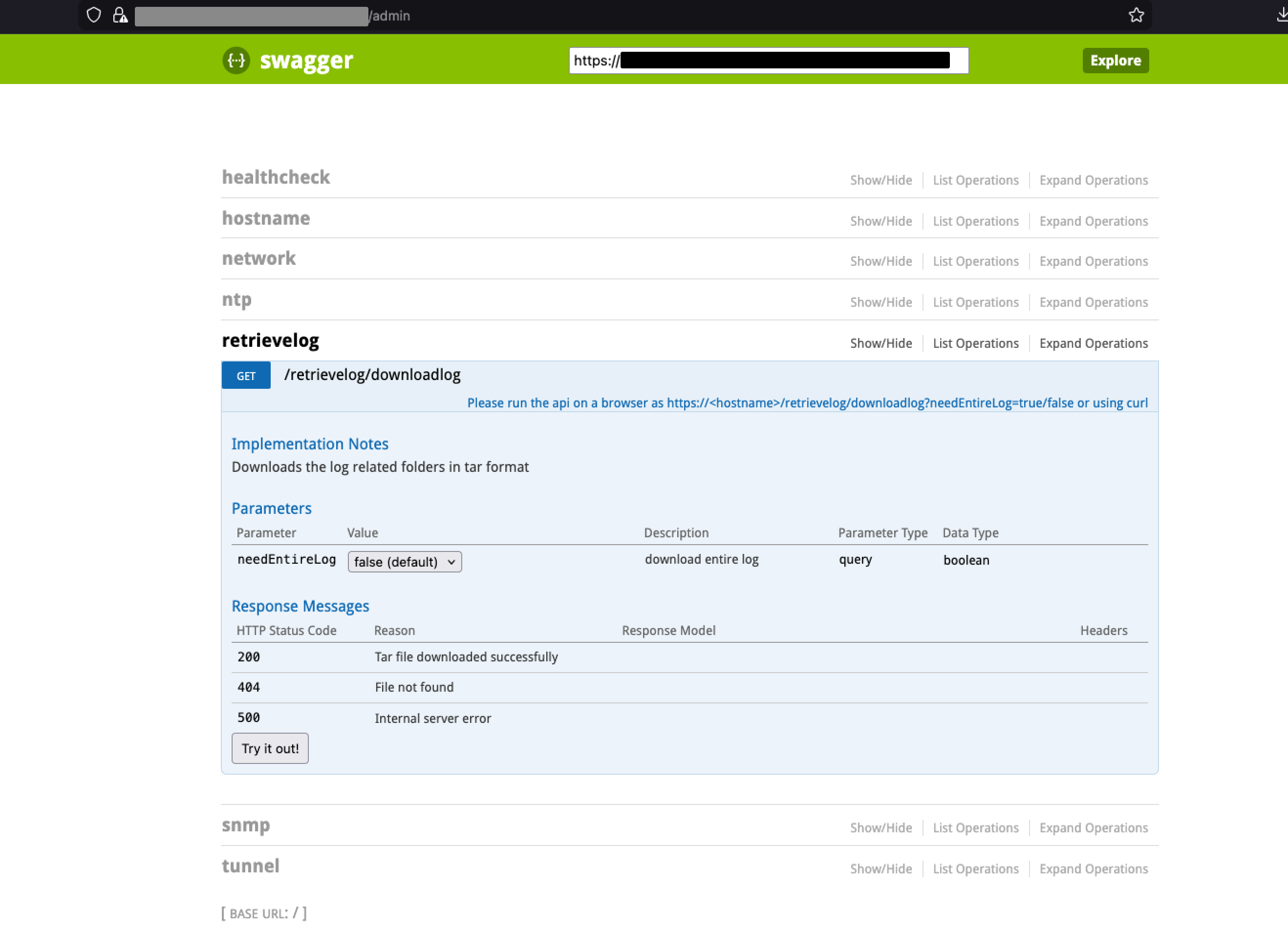

2.  Once your logged in, you can try accessing the Admin API interface at: https://<AppNeta On-Prem hostname or IP address>/admin
You will be prompted again to entering your username and password, before the login completes.

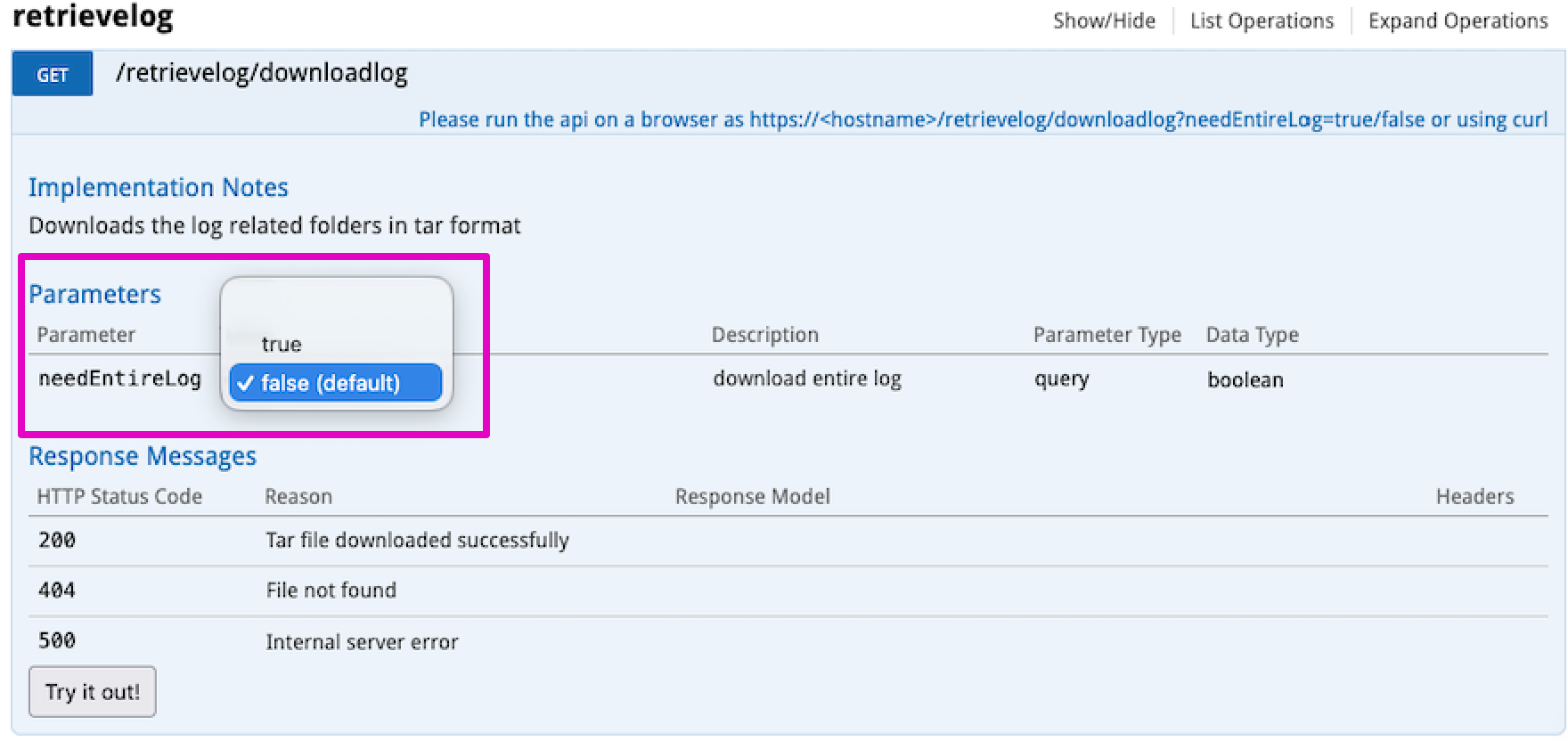

3.  Find the "Retrievelog' section and expand it:
4.  Be aware of the options to download the entire log files or partial logs.  Usually you will want complete logs if requested by the AppNeta support team, though partial logs might also be requested.
5.  Select the "Try it Out! " button
