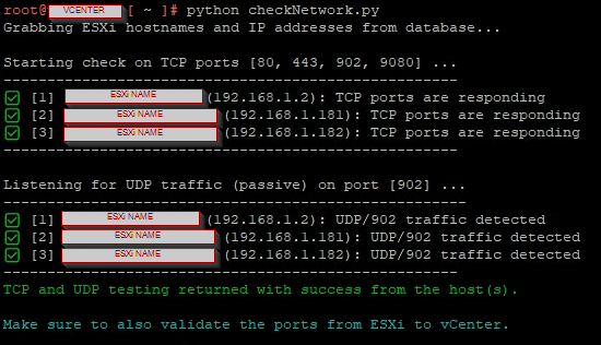

    • For all hosts managed by vCenter:
      python checkNetwork.py

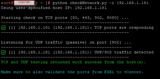

Output samples
When everything is fine:

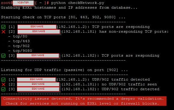

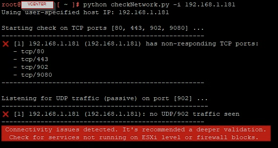

If a host totally unresponsive (i.e.: if ESXi is powered off, crashed (PSOD) or the required ports are blocked firewall):

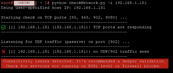

Testing only the affected host:
If hostd service stopped or unresponsive on the ESXi or if port 902 UDP traffic is blocked by firewall:
