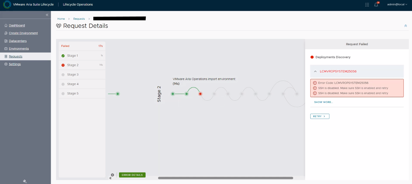

  • When attempting perform any task on VMware Aria Operations (formerly vRealize Operations) environment from VMware Aria Suite Lifecycle, the process fails at Stage 2.
  • The following error message is displayed in the Aria Suite Lifecycle UI: LCMVROPSYSTEM25056: SSH is not enabled on the node(s).

  • This issue occurs because VMware Aria Suite Lifecycle requires Secure Shell (SSH) access to the Aria Operations nodes to perform the discovery and import tasks.
  • If SSH is disabled on one or more nodes in the Aria Operations cluster, the lifecycle operation cannot proceed.
To resolve this issue, you must enable SSH on all VMware Aria Operations nodes. This can be achieved through the Administration UI.
  1. Log in to the VMware Aria Operations Admin UI (e.g., https://<vROps_FQDN>/admin).
  2. Navigate to the System Status tab.
  3. Locate the list of nodes in the cluster.
  4. Under the SSH Status column, toggle the status to Enabled for all nodes.
  5. Once the status shows as enabled, return to Aria Suite Lifecycle and click Retry on the failed request.
