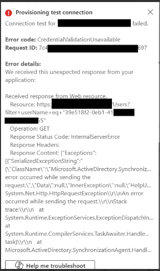

  • The Microsoft Entra Provisioning Agent (running on the on-premises Windows Server) fails to establish a valid HTTPS handshake with the vCenter Server.
  • The following error messages can be see while testing connection:
    • Error code: CredentialValidationUnavailable Error details:
      We received this unexpected response from your application: Received response from Web resource. Resource: https://<vc-fqdn>/scim/v2/Users... Operation: GET Response Status Code: InternalServerError
    • Error code: SystemForCrossDomainIdentityManagementCredentialValidationUnavailable
      Details: We received this unexpected response from your application:
      Response Content: System.Net.WebException\\r\\nThe underlying connection was closed: Could not establish trust relationship for the SSL\\\/TLS secure channel
      Type: System.Security.Authentication.AuthenticationException\\r\\nThe remote certificate is invalid according to the validation procedure
