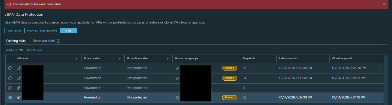

When trying to do a clone of a VM via vSAN Data Protection you get the following error "User initiated task execution failed."

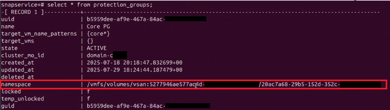

  1. Find the snapshot folder being used for the linked clone on the vSAN datastore
    a. Log into the snapservice applaince
    b. Run select * from protection_groups to list all VM snapshot info
    c. The path for the snapshot folder will be labeled namespace
  2. Locate all *.vmdk files for the active linked clone snapshots and delete or comment out the line with "changeTrackPath"
