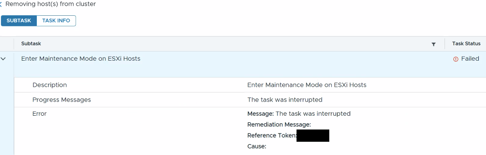

  • When attempting to decommission an ESXi host from a workload domain in VMware Cloud Foundation (VCF), the task becomes stuck or fails in the SDDC Manager UI.

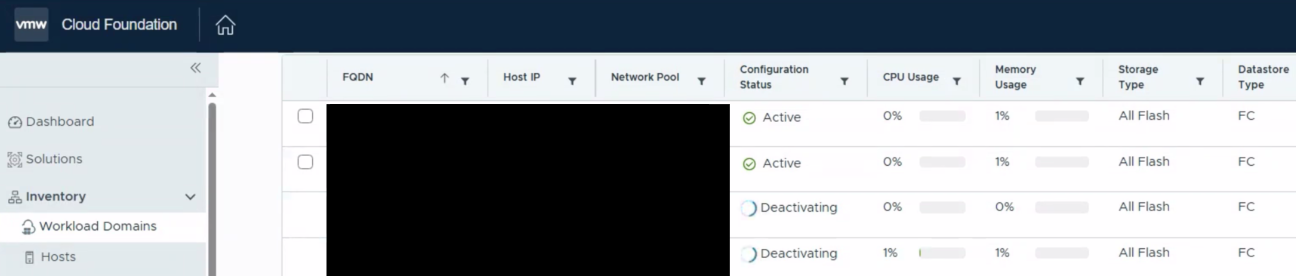

  • This issue can also manifest when decommissioning a Workload Domain fails because one or more ESXi hosts within that domain are stuck in a 'Deactivating' state in the SDDC Manager inventory, blocking the domain removal process.
  • The host decommissioning task remains in a Deactivating state.
  • SDDC Manager UI displays the following error:
In /var/log/vmware/vcf/domainmanager/domainmanager.log, the following snippets are observed:
