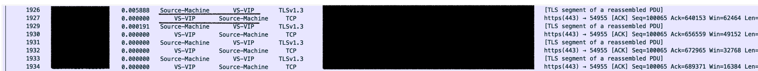

Collect the Virtual service packet capture and observe if we are noticing the following behaviour
Collect-Virtual-service-packet-capture

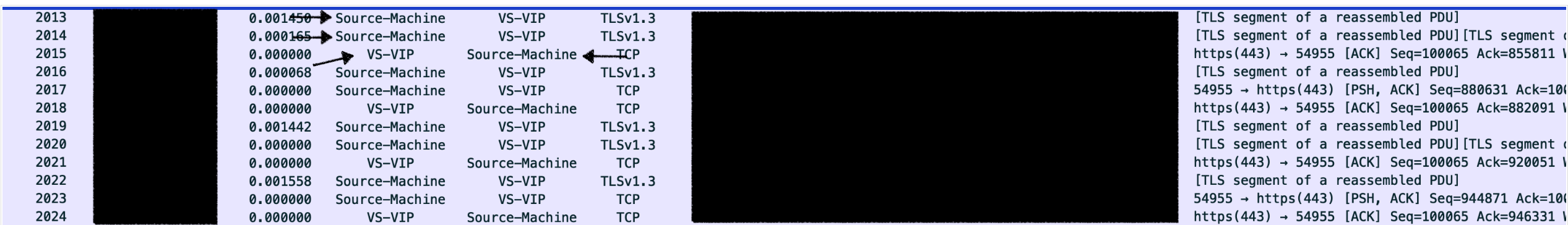

  • Avi Load Balancer implements TCP delayed acknowledgment (delayed ACK) to reduce the number of ACK packets sent. With delayed ACK enabled, Avi may acknowledge every second received TCP segment or send an ACK after a timeout (typically up to ~100 ms) if no additional segment arrives.
  • During a file upload from the client to the server, at the initial stage of data transfer, the Avi Load Balancer acknowledges for every packet as the TCP connection ramps up.
  • As the data transfer stabilises, Avi gradually applies the delayed ACK mechanism to reduce ACK traffic. In this phase, Avi sends one ACK for every two TCP segments received from the client, which is expected TCP behavior when delayed ACK is in effect.

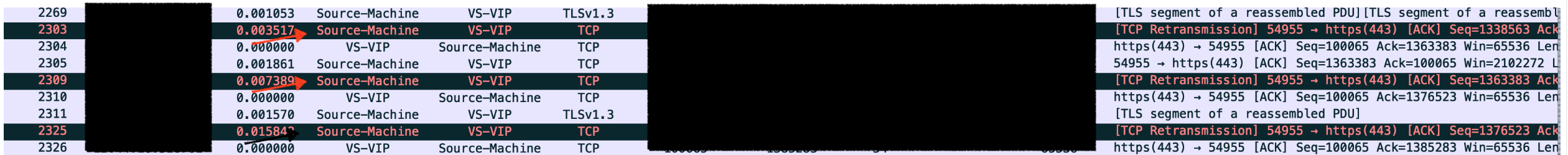

  • Over time, if the client is unable to send multiple TCP segments back-to-back (for example, due to congestion or window limitations), TCP retransmissions may occur. In Below screenshot source machine is re-transmitting the packets.
  • Each retransmission triggers an immediate ACK from Avi. As retransmissions increase, the client’s effective send rate decreases, which can result in slower file upload performance.
If traffic captures exhibit patterns similar to those described above, the behavior is likely caused by the Delayed ACK mechanism implemented in the AVI Load Balancer.

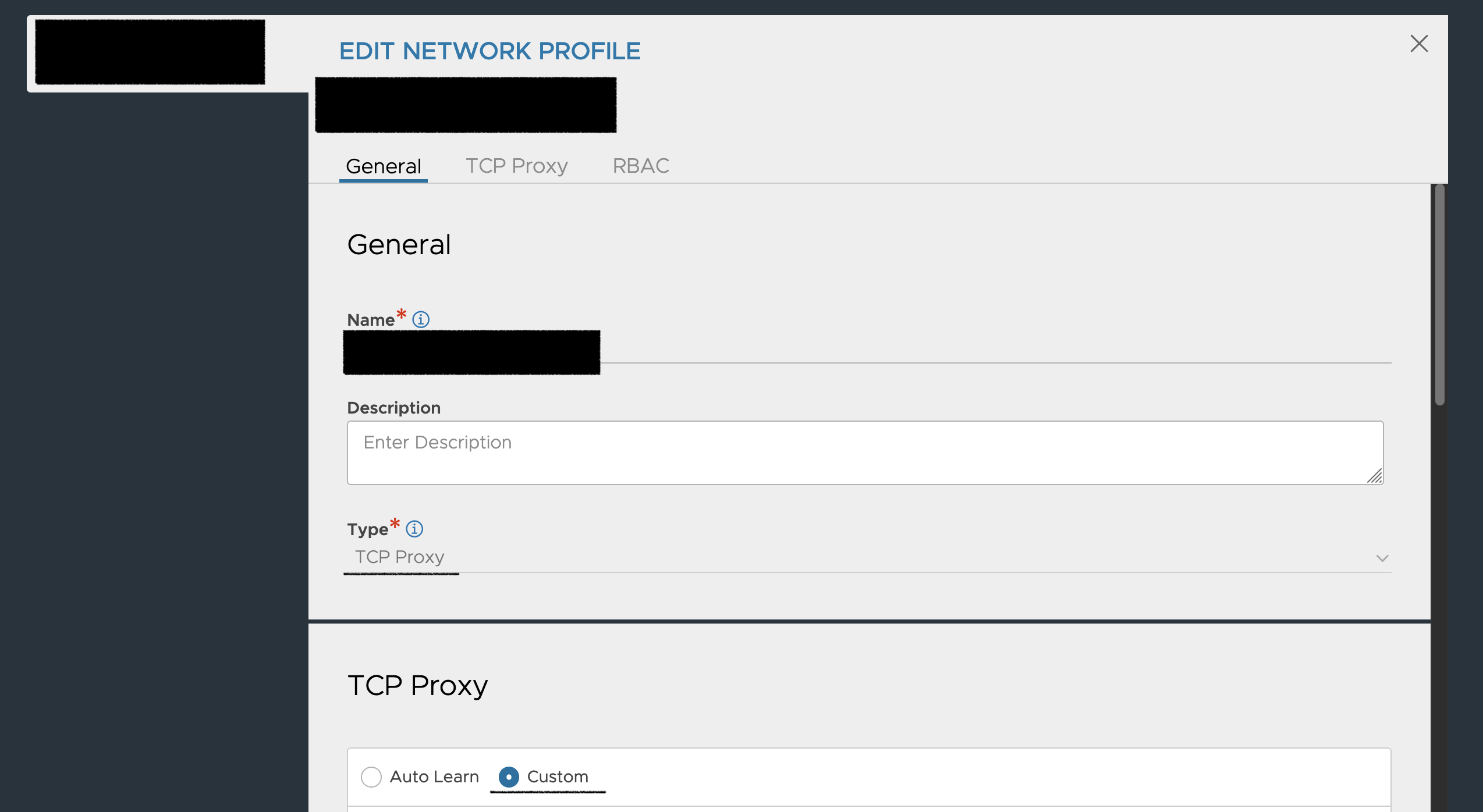

Step-1: Create a new network profile
Navigate to Templates >> Profiles >> Network click on CREATE button
Please select the below settings and leave remaining settings as it is.
