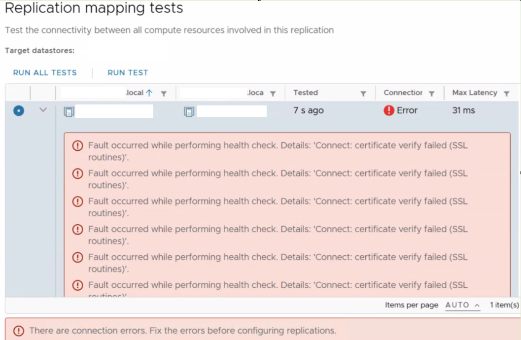

When performing an Enhanced Replication mapping test or configuring replication, the process fails with the following error:

The error is triggered by a communication failure between the Source ESXi hosts and the Target Infrastructure. While the error message points to a certificate verification failure, the root cause is typically a network timeout preventing the SSL handshake from completing.
