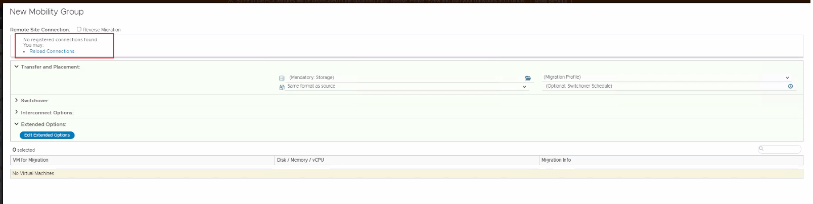

HCX GUI responding slow during migration task configuration on destination site. It cannot fetch and refresh the remote site data with error: "No registered connections found."

  • Creating a New Mobility Group from the HCX Cloud Manager web interface takes a long time and after a while the migration wizard displays the message: "No registered connections found.":

  • During the troubleshooting to determine why the HCX UI response is slow, using a HAR file and Developer Mode, the following response is observed: "502 Proxy Error"
VMware HCX
This issue can occur if there is a proxy configured on the HCX Manager port 9443, and there is no exclusion for the remote site pairing.
Add a proxy exclusion for the remote site pairing, for more information, please access: Configure a Proxy Server
