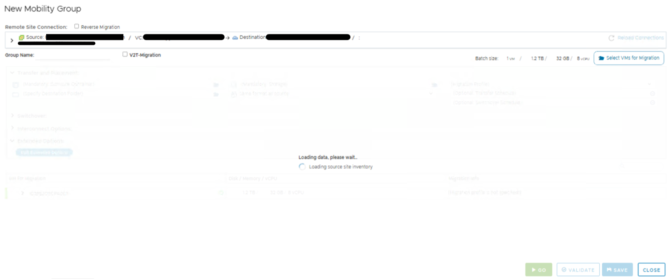

The "New Mobility Group" page is stuck at loading and the page is blank:
