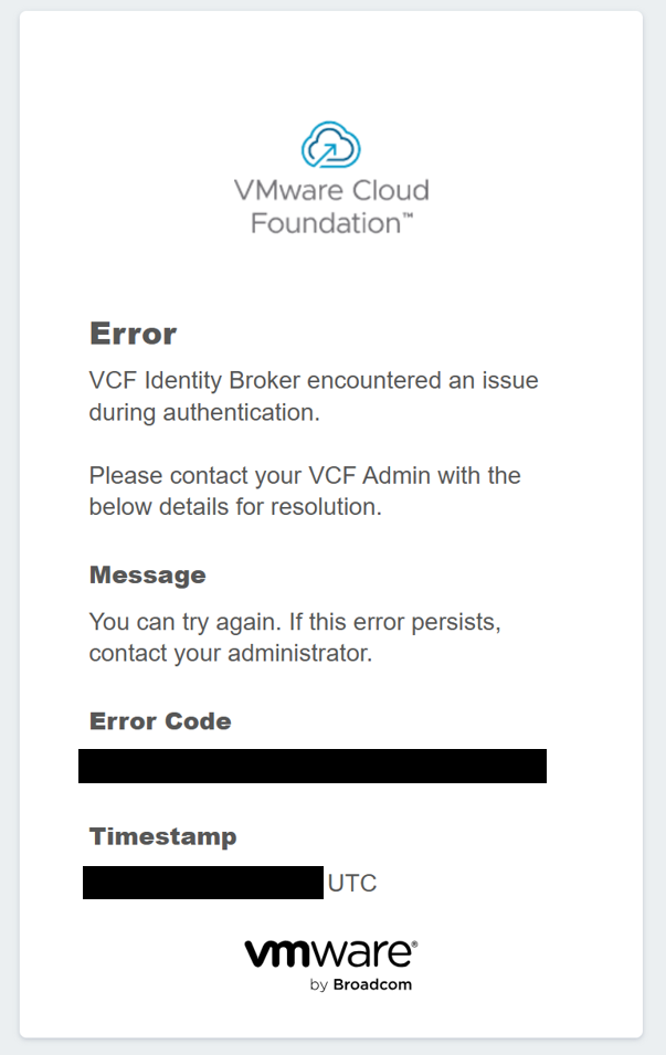

  • The Identity Broker was deployed with 3-node cluster structure;
  • Sometimes, when trying to login VCF component, such as VCF Operations or Fleet Management, during redirecting the login request to Identity Broker, the web page was redirected to an error page with "Error: VCF Identity Broker encountered an issue during authentication. Please contact your VCF Admin with the below details for resolution. Message: You can try again. If this error persists, contact your administrator."

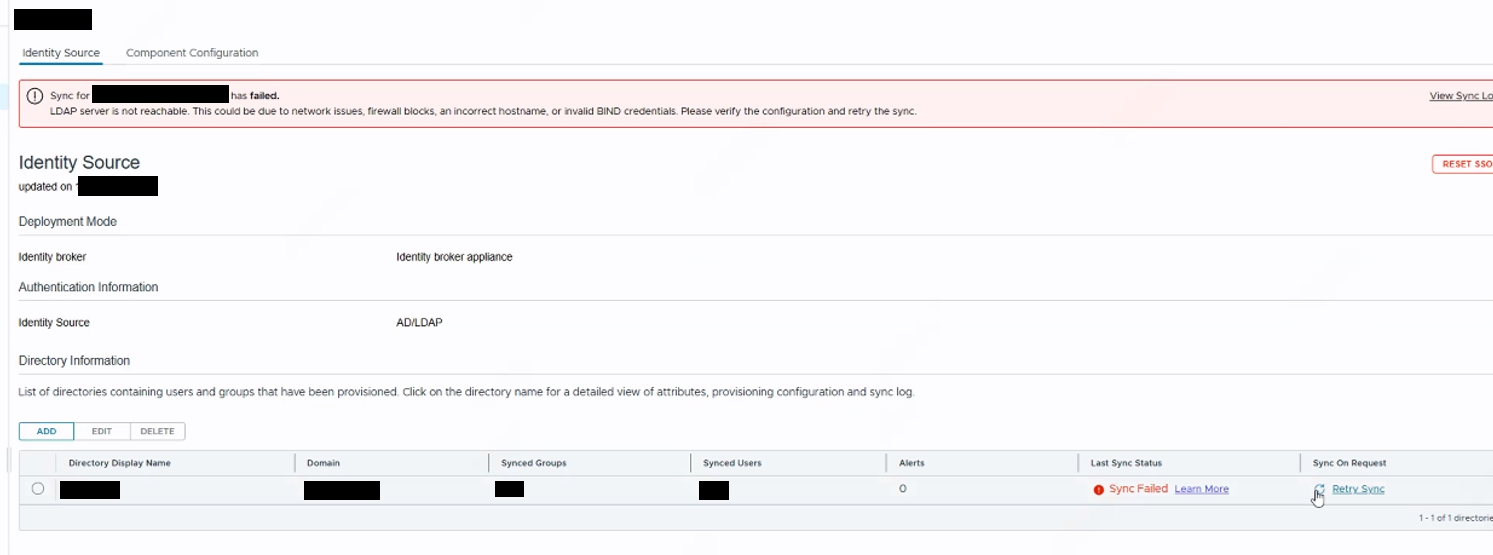

  • When synchronizing with domain controller, it may return "Sync Failed" intermittently. On the title bar, there is error as "LDAP server is not reachable. This could be due to network issues, firewall blocks, an incorrect hostname, or invalid BIND credentials. Please verify the configuration and retry the sync".
