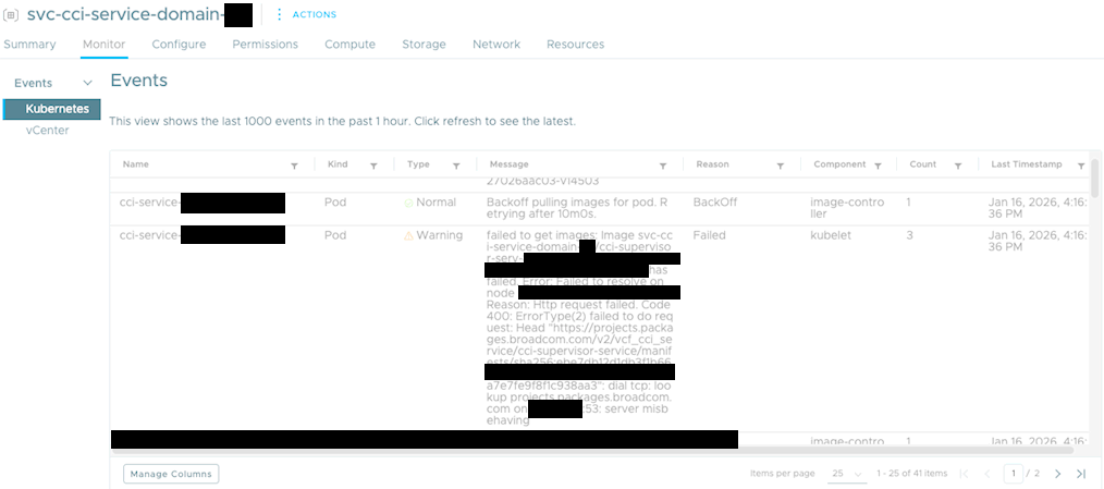

During the installation or upgrade of the Cloud Consumption Interface (CCI) in a VMware Cloud Foundation (VCF) environment, pods may fail to start and remain in ErrImagePull status.
Checking the pod state logs at /var/log/vmware/podstate reveals the following error:
message": "failed to sync pod \"svc-cci-service-domain-<domain id>/cci-service-<uuid>" in the provider: failed to pull images: failed to get images: Image svc-cci-service-domain-<domain id>/cci-supervisor-serv-<uuid> has failed. Error: Failed to resolve on node <ESXI host name>. Reason: Http request failed. Code 400: ErrorType(2) failed to do request: Head \"https://projects.packages.broadcom.com/v2/vcf_cci_service/cci-supervisor-service/manifests/sha256:<SHA Value>\": dial tcp: lookup projects.packages.broadcom.com on <IP of DNS server configured in workload network settings>:53: server misbehaving: ErrImagePull",
