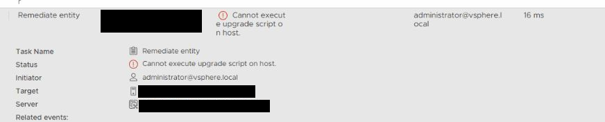

  • Patching ESXi host using SDDC Manager may fail with error "VUM Remediation (installation) of an ESXi host failed"
  • vSphere Client session reports the failure as "Cannot execute upgrade script on host"
