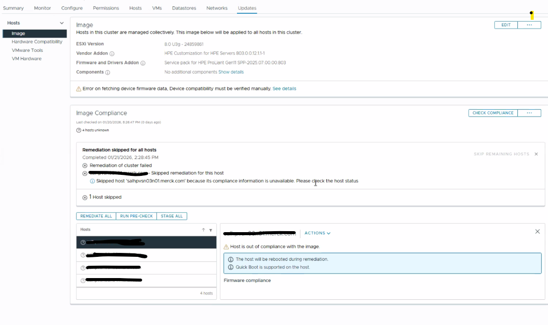

Firmware and Drivers Add-on remediation fails when initiated from vCenter Server for vSAN clusters using vSphere Lifecycle Manager (vLCM).
The remediation task reports the following errors:
  • Remediation of cluster failed
  • <host> Skipping remediation for this host
  • Skipping host because its compliance information is unavailable. Please check the host status.
  •  vCenter [Scan Task] Unable to find the baseline profile with the provided version
