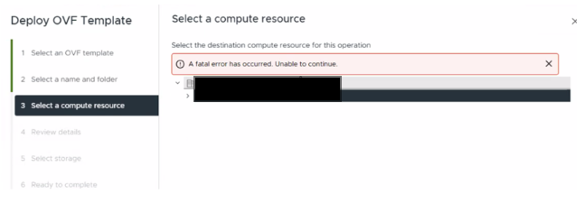

When deploying an OVF template in a vCenter Server 9.x environment, the deployment fails immediately with the following error:
A fatal error has occurred. Unable to continue.
