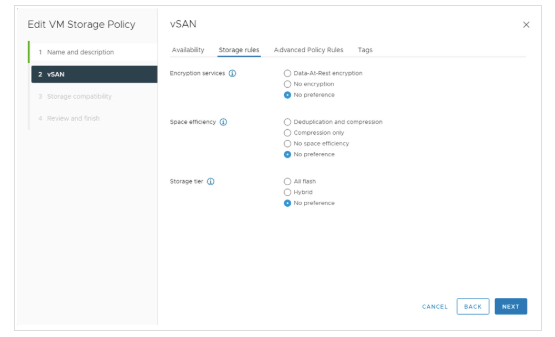

  • For vSAN OSA, Storage Policies cannot enforce settings for Space Efficiency on the vSAN Cluster
  • Space Efficiency settings on the vSAN cluster for vSAN OSA is always the setting configured on the cluster
  • Change the Space Efficiency rule in the Storage Policy to "No Preference"
  • This will ensure that the policy uses the Space Efficiency setting of the cluster and will ensure compatibility of the space efficiency settings between the storage policy and the cluster
Note: Do not use any other option for Space Efficiency in the Storage Policy for vSAN OSA
