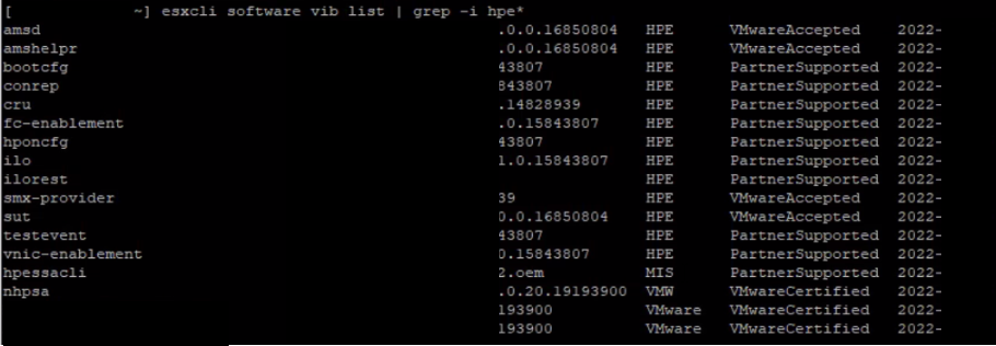

  • Non-HPE Hardware (e.g., Dell, Cisco, Supermicro) containing legacy HPE-signed VIBs, or HPE hardware with deprecated management VIBs.

  • Perform a manual removal of all irrelevant HPE VIBs from the ESXi host via the command line interface. Removing the conflicting vibs ensures a "clean" upgrade path, allowing the ESXi 8.0 network stack to initialize without vibs conflicts.
    esxcli software vib remove --vibname=<name>
