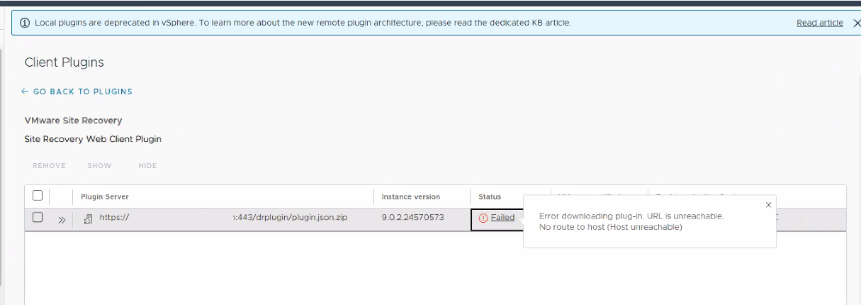

  • When attempting to reinstall or reconfigure Site Recovery Manager and vSphere Replication appliances, the plugin fails to deploy.
  • The reconfiguration task initiated on the SRM and VR appliances completes successfully
  • Once the appliance is configured successfully via the VAMI, returning to the vSphere Client displays the below error. The status of the plugin can also be verified under vCenter Server Menu > Administration > Client plugins
    Error downloading plug-in. URL is unreachable. No route to host (Host unreachable)
  • The URL cited in the error points to the IP/FQDN of an old or powered-off vSphere Replication or SRM appliance.
