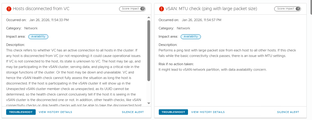

  • In the VSAN skyline health accessible via vCenter server > VSAN Cluster > Monitor > VSAN > Skyline health, below errors are observed
VMware VSAN 8.x
