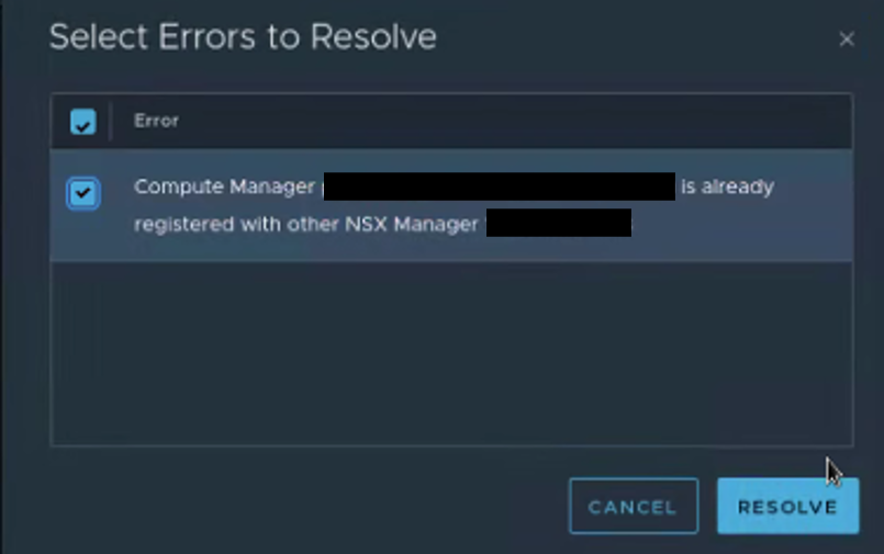

  • An error occurs when attempting to add a compute manager to NSX stating that the compute manager is already registered with another NSX manager.
Error: "Compute manager <name> is already registered with other NSX manager <IP:port>"

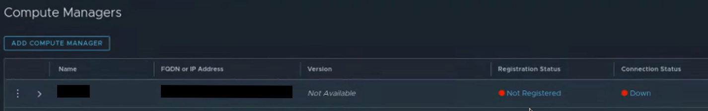

  • Compute manager Registration status shows 'Not Registered' and Connection Status as "Down"
