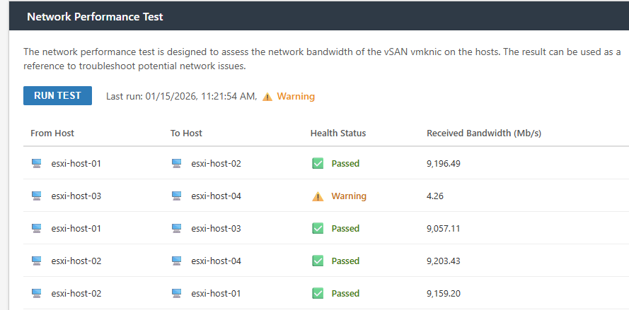

Bandwidth issues shows between ESXi host during network proactive test
  Path :  Cluster > Monitor Tab > vSAN > Proactive Tests > Network Performance Test
VMware VSAN 8.x
  • Network instability between ESXi hosts resulted in packet loss and bandwidth degradation.This network behavior caused increased latency, directly impacting database VM performance and delaying archive log replication between database servers
