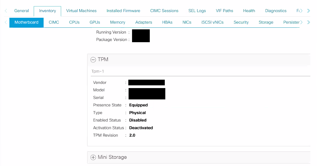

From the Hardware Management Page, it is evident that the TPM is present but the Enabled Status is "Disabled" and the Activation Status is "Deactivated"
The physical TPM module is detected by the ESXi kernel, but it is administratively Disabled or Deactivated in the server's firmware.
To resolve this issue, the TPM must be fully enabled at the hardware level. Contact Hardware Vendor to turn on the Enablement Status and Activation Status.
