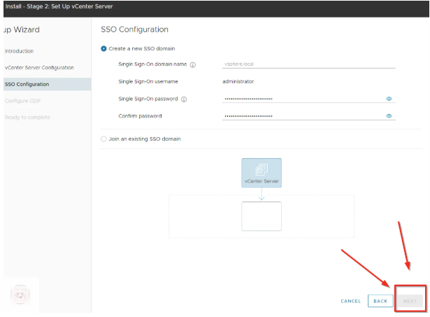

  • During the vCenter Stage 2 Install process, the buttons are greyed out.
We will find following messages in /var/log/vmware/applmgmt/applmgmt.log
YYYY-MM-DDTHH:MM:SS PM UTC [8030]ERROR:detwist:Method failure = <twisted.python.failure.Failure vmware.vherd.base.pint.Error: pint.Error: pint.Error('com.vmware.applmgmt.err_status_does_not_exist', "Status for '%(0)s' does not exist.""
YYYY-MM-DDTHH:MM:SS PM UTC [6655]ERROR:vmware.appliance.extensions.authorization.authorization_sso:Failed to get certificate or key from VECS Traceback (most recent call last):  File "/usr/lib/applmgmt/lib/extensions/py/vmware/appliance/extensions/authorization/authorization_sso.py",
vCenter 8.x, 9.x
  • The installer UI may not register pre-filled SSO domain information until the user manually interacts with or re-types the field.
  • vCenter server DNS entry not defined.
  • Manually type the Single Sign-On domain name (e.g., vsphere.local) into the SSO domain name field to trigger the installer's validation logic.
  • Define DNS records for the vCenter server prior to installation.
