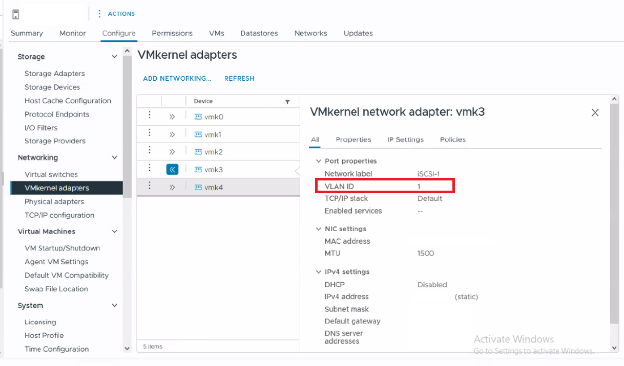

  • From the vmkernel interface configuration, it is observed that on both working and non-working ESXi hosts, the vmkernel interface has VLAN configured.
    For example, in the below screenshot, vmk3 interface is used for iscsi connectivity and there is a VLAN tagging.

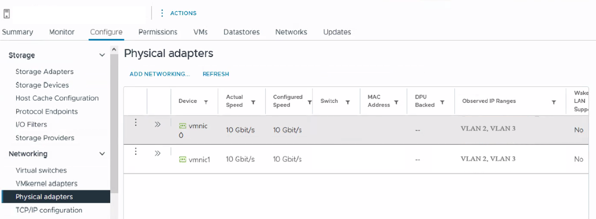

  • On the working ESXi hosts, the physical adapters do not have any specific VLAN tagging or restriction. However, on the non working ESXi host, there is VLAN tagging at the physical switch and this does not allow the traffic through VLAN1
    Non working host:
  • Also, on reviewing the VLAN stats, on the problematic ESXi host, there are no packets received for the VLAN1
