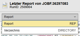

When the AWI logon language is set to German or French, the PREP_PROCESS_REPORT function fails to retrieve results.

Report:
2026-01-19 21:18:35 - U00063089 FT '2509004': Dateien ausgewählt: '10'.
There is no post-processing available.
