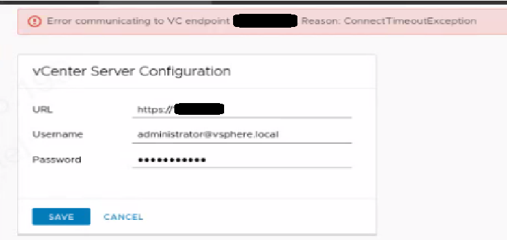

HCX Manager -- Error communicating to VC endpoint <IP>:443. Reason: Connection TimeoutException"

  • When attempting to register the vCenter, the following error is observed: "Error communicating to VC endpoint IP:443. Reason: Connection TimeoutException"
  • Ping test to vCenter IP & FQDN is successful. However, the curl to vCenter failed with "TLS Handshake".

It is identified the " TLS1.2 -- Client Hello" packet sent from the HCX was dropped in the L3 routing device and not seen on the firewall, due to which the vCenter was re-transmitting "SYN,ACK" continuously to the HCX.
